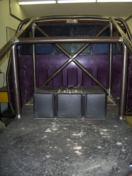

The bed, box, and fuel cell done.
Attachment 6666

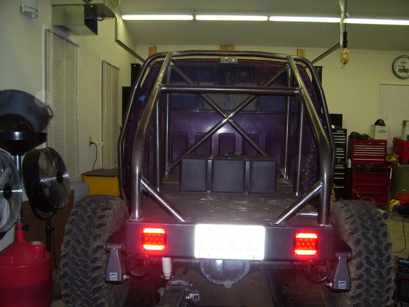

93 Krawler 05-04-2013 09:59 PM
5 Attachment(s)
Working on the rear cage
Attachment 6670
Attachment 6671
Attachment 6672
Cage almost done. Added some bracing and cab protection later. Still IFS at this point.

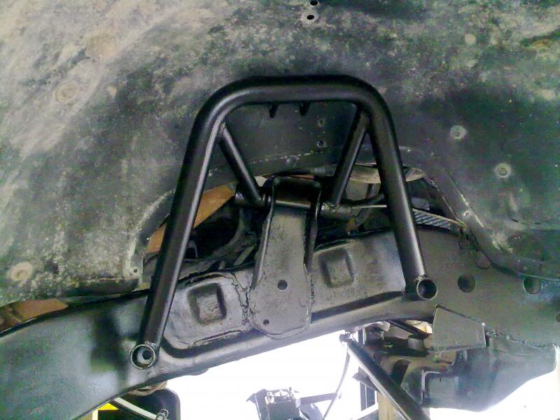

93 Krawler 05-04-2013 10:26 PM
5 Attachment(s)
Added some front end protection. This was supposed to be the start of the front exo. I never liked the way the tube looked that came down from the top, so I never finished it, Until...
Attachment 6680

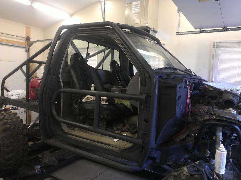

New tube doors.
Attachment 6681

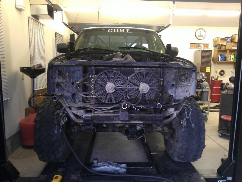

I got sick of all the heat inside the engine compartment and tryin to see around the hood and fender so the dog house got removed. This was the only way to get the exo look I wanted.
Attachment 6682
Attachment 6683

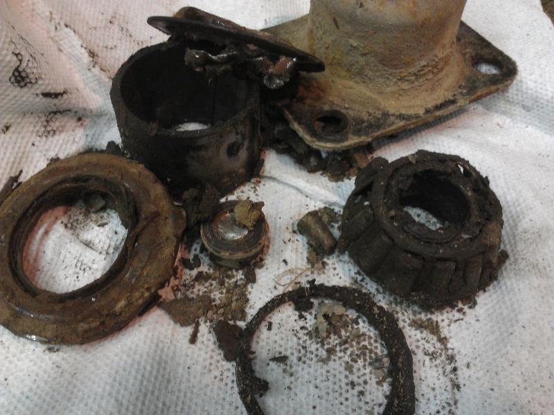

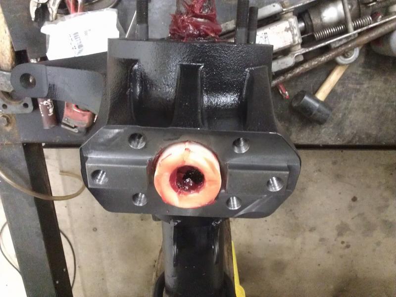

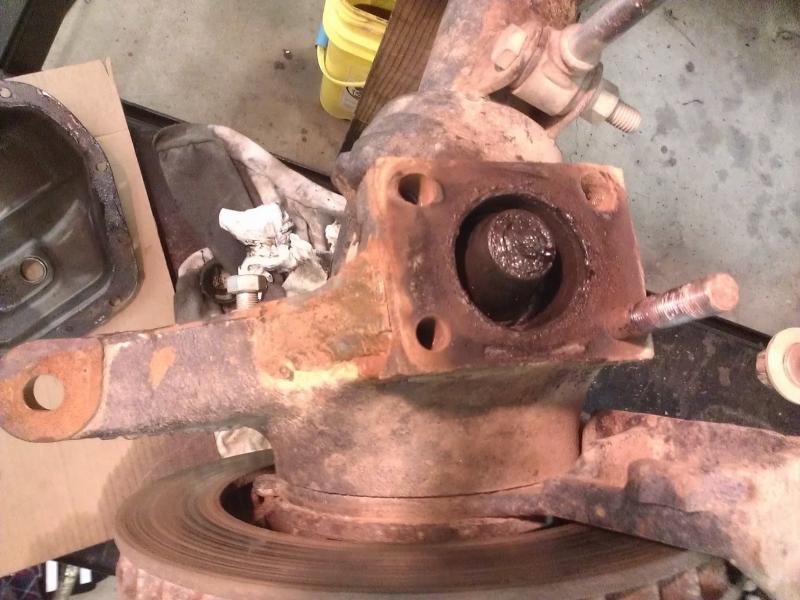

93 Krawler 05-05-2013 09:15 PM
4 Attachment(s)
I cracked the knuckle in Harlan and patched it to get me through the rest of the weekend. After getting the new knuckles, I decided to not use my old 4 bolt high steer arms and get the Solid 6 bolt arms. Hopefully I get them in the next few days.
Attachment 6691
I upgraded to the Solid Axle steering knuckles. The difference between the two are huge.
Attachment 6692
Attachment 6693
The lower king pin bearings are probably original and in horrible shape.
Attachment 6694
