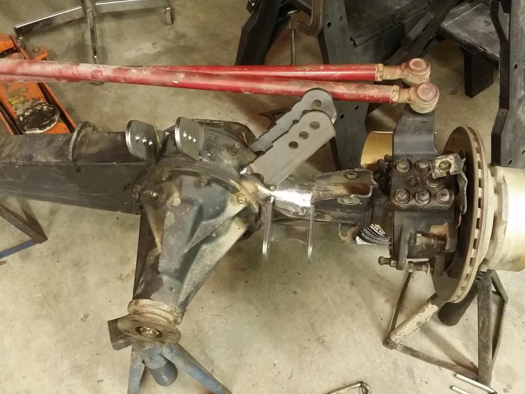

Toyota Front 3 link
So the time has come to link the front of my Rig, I have had alot of broken springs over alot of years and with the terrain that I tackle my body had been taken a beating along with my Rig

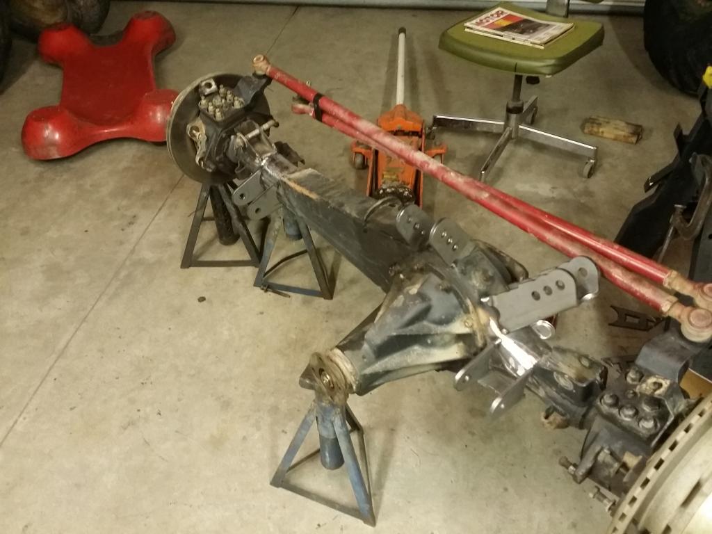

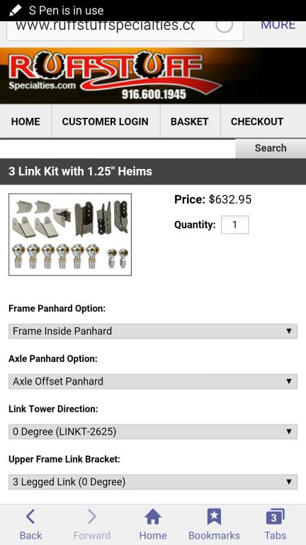

There are alot of different places to shop for weld on tabs, Heims, and brackets of all sorts, I had to figure out if I was gonna custom make most of my link mounts or go with some good quality mounts that I can customize to make work for my needs, this turned out to be the best decision.
I did have to customize some of the brackets to work for my project, but let's face it, alot of rigs are PMC..Pretty much custom. I could not beat the price of the Heims for this price for as much as I shopped around. It made pretty quick, nice work out of most of this setup

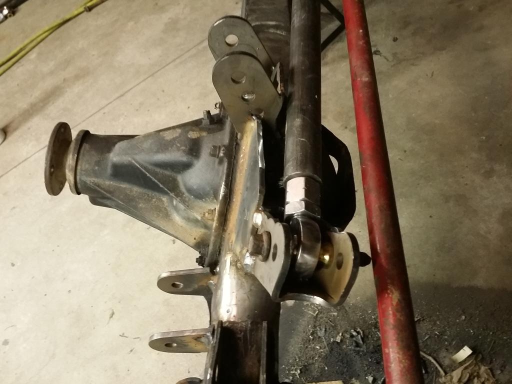

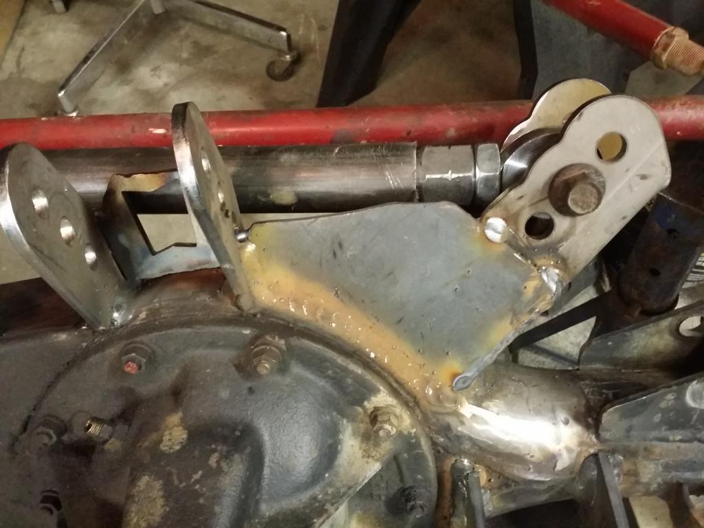

These lower link mounts worked out pretty good with only 1 of them needed modification

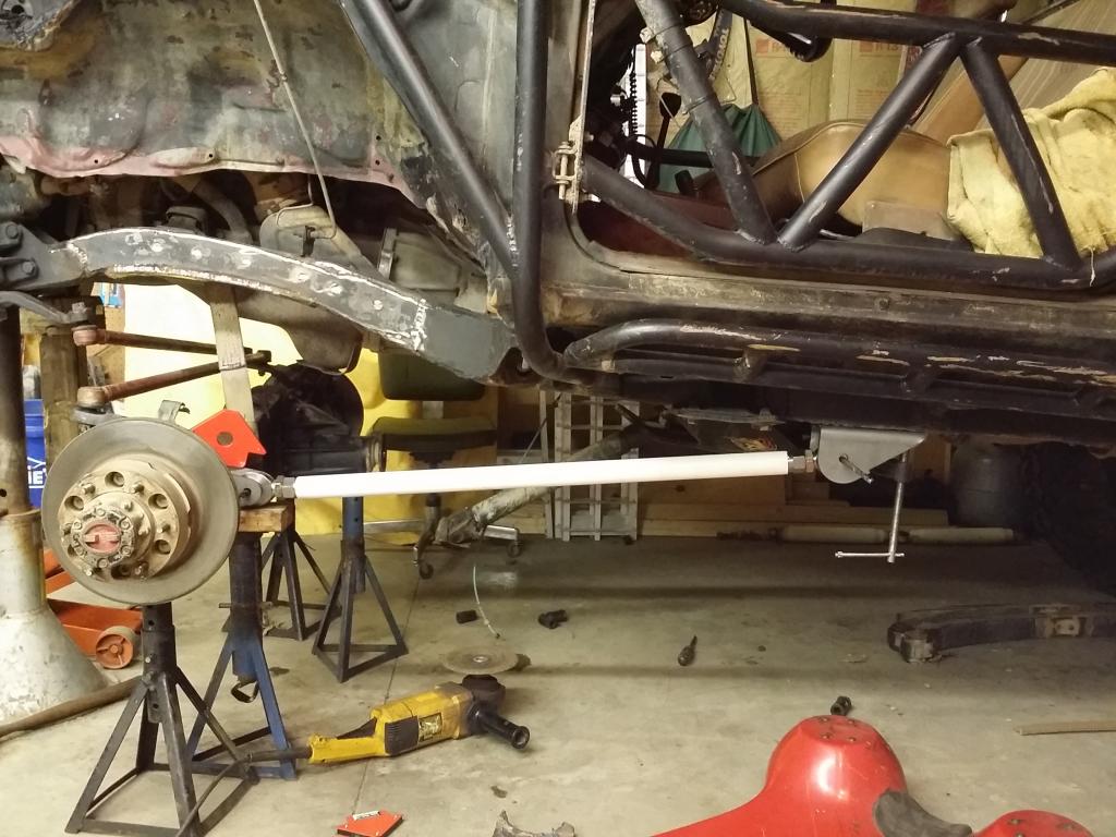

Mocking up with PVC is alot of fun and alot of duct tape, Make sure you buy ALOT.

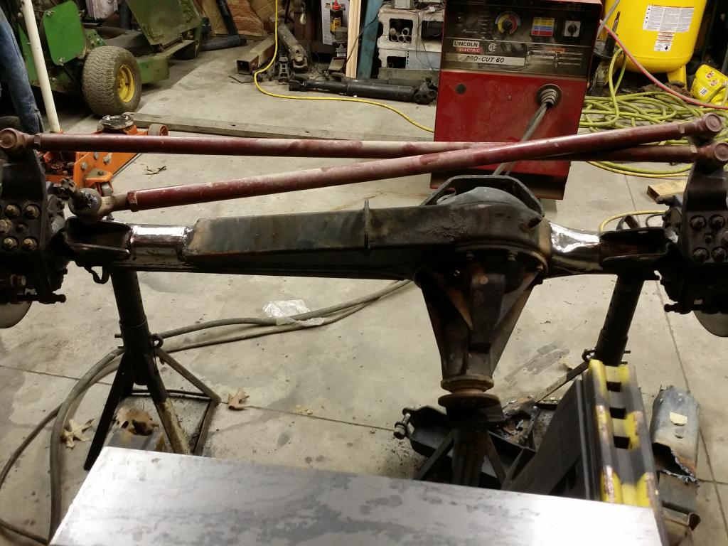

After alot of investigation and horror stories I would advise beefing up the Frame where the panhard mount will be located, You cannot overdue this !! This is a major common fail on a front 3 link, I used 1/4 plate over the frame on the side and in the bottom and plug welded, make sure you spread it way beyond the stress point.

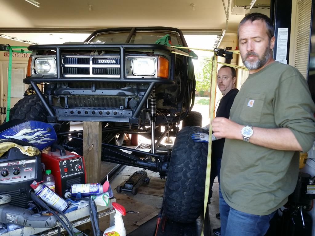

Measure so many times that you will be sick of measurements when you are tacking things in place, I found a few mistakes and had to remove and remeasure again.
Don't get in a hurry in this or you will regret it, there are alot of angles and things that will be very close while flexing and turning when you still have steering and you haven't changed over to full Hydraulic.

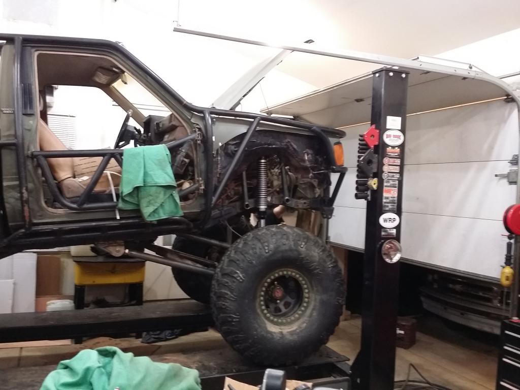

Not sure if it's the angle of the picture or not but you may want to consider the panhard mount on the axle and shock interference? May just be the angle though not sure

Thanks for answering for me Mark, yes things are close but ok, will hopefully have truck on RTI ramp tomorrow to max out suspension to look things over, Mark, Kevin, and I played with it last weekend on the lift and it appears everything will be ok but prefer to twist everything up as much as possible. With suspension fully compressed steering is bout 1/8 of a inch away from the oil pan and my top link bar is bout 1/2 away from clutch slave cylinder. Will post up more pics and info as I can.

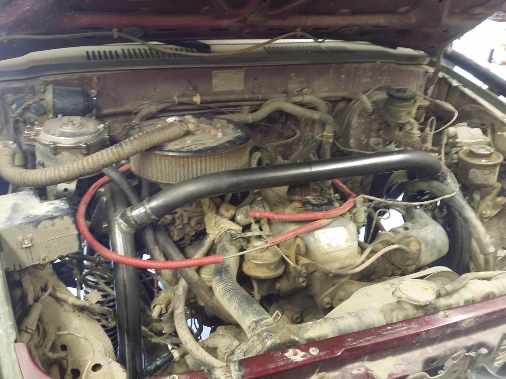

Awesome Job done by Kevin and Mark on Monday making the crossbar under the hood, Mark spent alot of time welding on my rig for me.

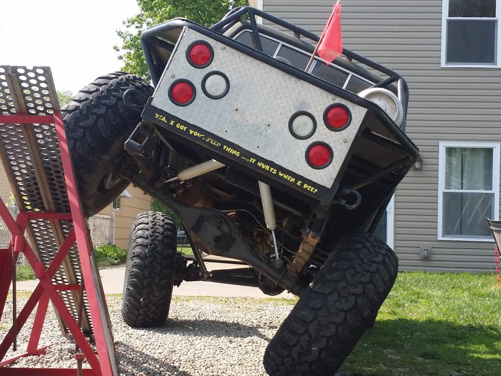

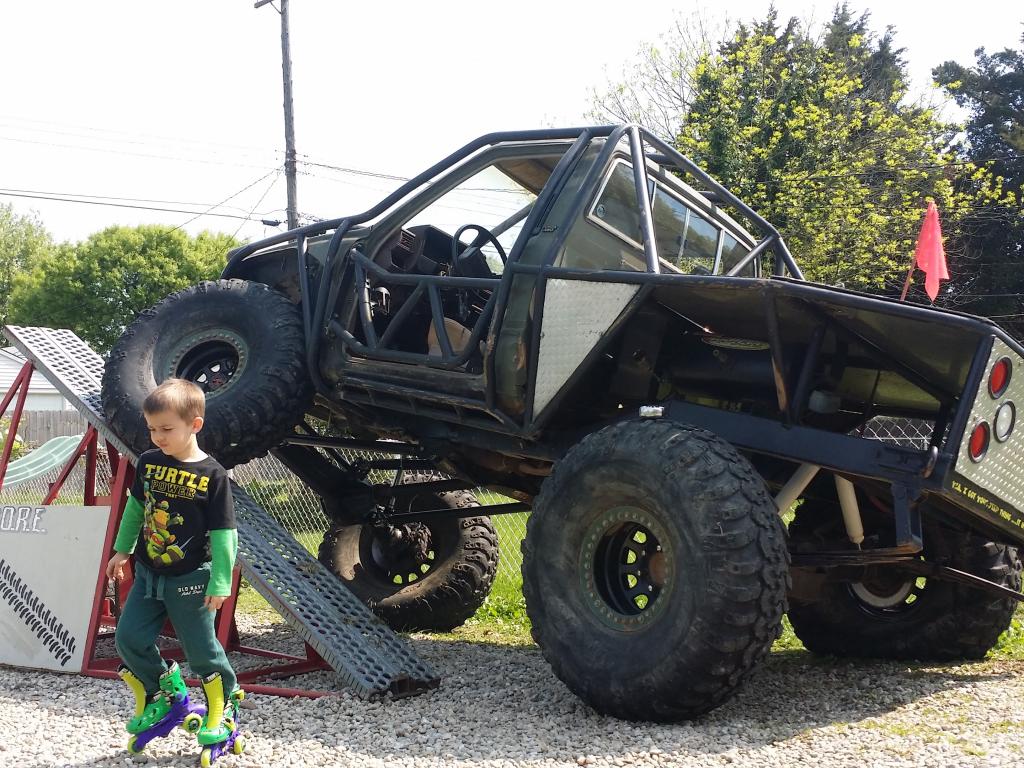

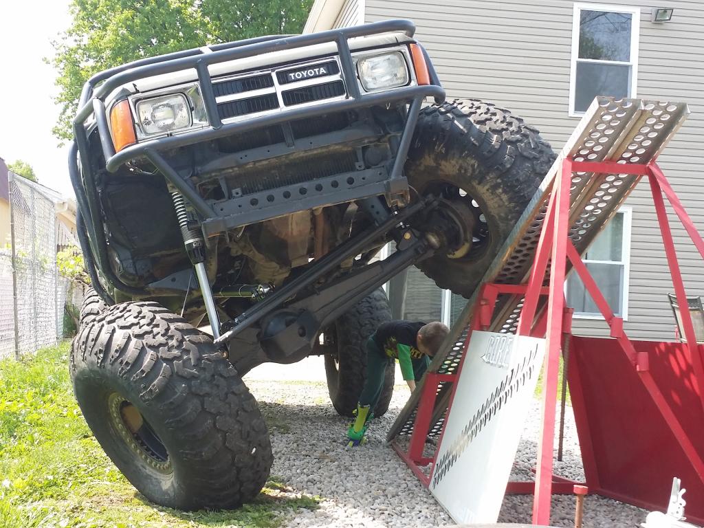

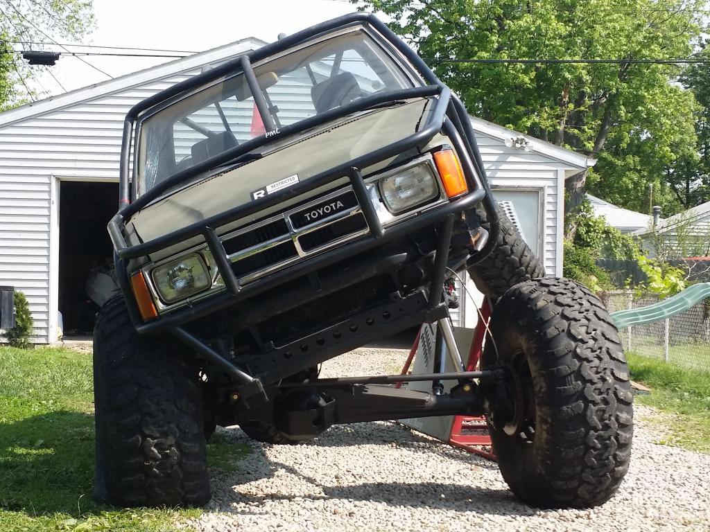

Well here is what I have do far, I have 2 inches of shock left to extend but after falling of the ramp twice I decided to give up, I'm glad I did, ORI is starting to dig into frame and hit steering shaft, will have to do some clearancing this weekend

Old 05-06-2016, 11:25 AM   #22
Same story with passenger side had to stop going up ramp or risk damage to ORI due to contact with the frame.
