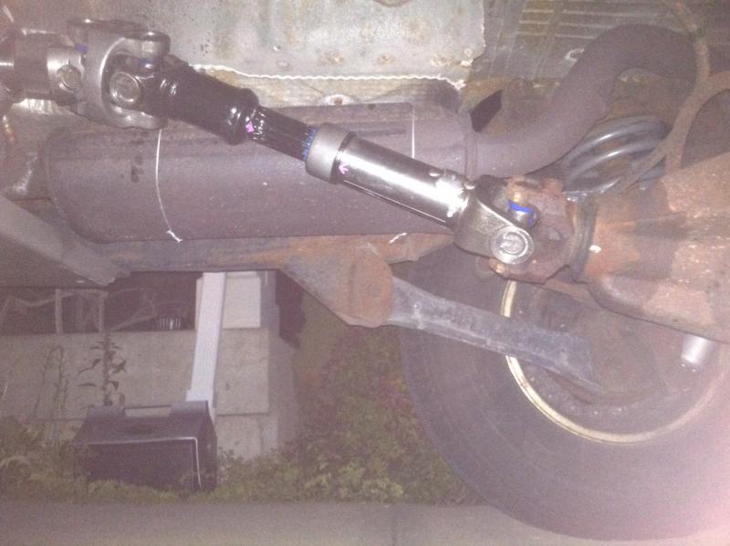

I have completed phase 1 of my tj project.
Belly up skid plate
Sye kit
2.5" lift
Today I installed my new cv drive shaft and took it for a test drive. I have a vibration between 25 and 40 mph.
Look at my driveshaft and pinion angles. Do you think I need to adjust my pinion or is it close enough? I think it is a little low and needs to come up.

the axle pinion needs to look straight at the tc.. so your pumpkin need some altitude
http://www.myjeepxj.com/uploads/imag...p/cv_angle.gif

yupp needs to come up some.
