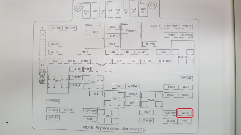

Going over the manual, I did find a separate fuse for the hazards, "HAZ LP" in the lower right.
I'll check that one when I get home. MAYbe it uses that signal to "flash" both trailer turns at once? I dunno...

...a separate fuse for the hazards, "HAZ LP" in the lower right. I'll check that one when I get home...
I didn't have much time to mess with it today, had to get the grass cut before the rain. But I did check that fuse, and it looked good. I didn't take time to put a meter on it.
