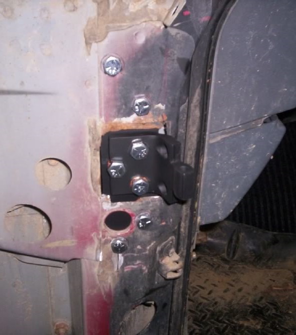

It took a little wiggling to get it into position, but the plate bolted in nice and solid. Then I bolted the hinge to it; and finally rehung the door:
Old 03-12-2018, 04:52 PM   #7
Overall, I'm thrilled with the results. I was hoping just to get the stupid door back on. But the new mount lifts it back up where it should have been all along, and it opens and closes better than it has in years.
I was careful to put the hinge right back where it was originally, and like I said, it does work well. If I was to do it again, though, I might move the hinge forward (toward the front of the jeep) about a quarter inch. That way I could shim the door-side mount to exactly where I wanted it, and even adjust it over time if it started to sag again.
All told, it took me about an hour and a half (not counting the time to pull off the fender), and since I picked the plate out of the scrap at work, I was only out seven 3/8" bolts. (Even buying a foot of the flatstock would only be $4 at OnlineMetals.)
Hope it helps somebody!

It finally got warm enough to get my fender back on, and I discovered a little wrinkle.
There was originally a tab tacked onto the body just below the hinge. I thought it was unused, and since it was right where I wanted to put my bolt hole, I snipped it off...
Old 03-12-2018, 04:54 PM   #9
Well, it turned out that tab was one of the ones used to mount the fender. Without it, there is a bit more play in the fender. Not a lot, but a little.
So the way I figure it, there are three courses of action.
(1) You could reposition that bottom hole to work around that tab. I'm sure it could be done, but to see exactly how and where, I'd have to tear it all back apart. And sorry guys, I'm just not that interested...
(2) You could make up a new tab that mounted under that bolt head. Just a small piece of light-gauge sheet, bent into an "L", with a hole in each leg.
(3) You could ignore the whole thing, because your rig is already rusting to pieces in the driveway, and a little play in the fender really won't be noticed.
I chose number three.
But I thought I'd mentioned it, so anybody that might try my fix can decide for themselves, and adjust accordingly...
