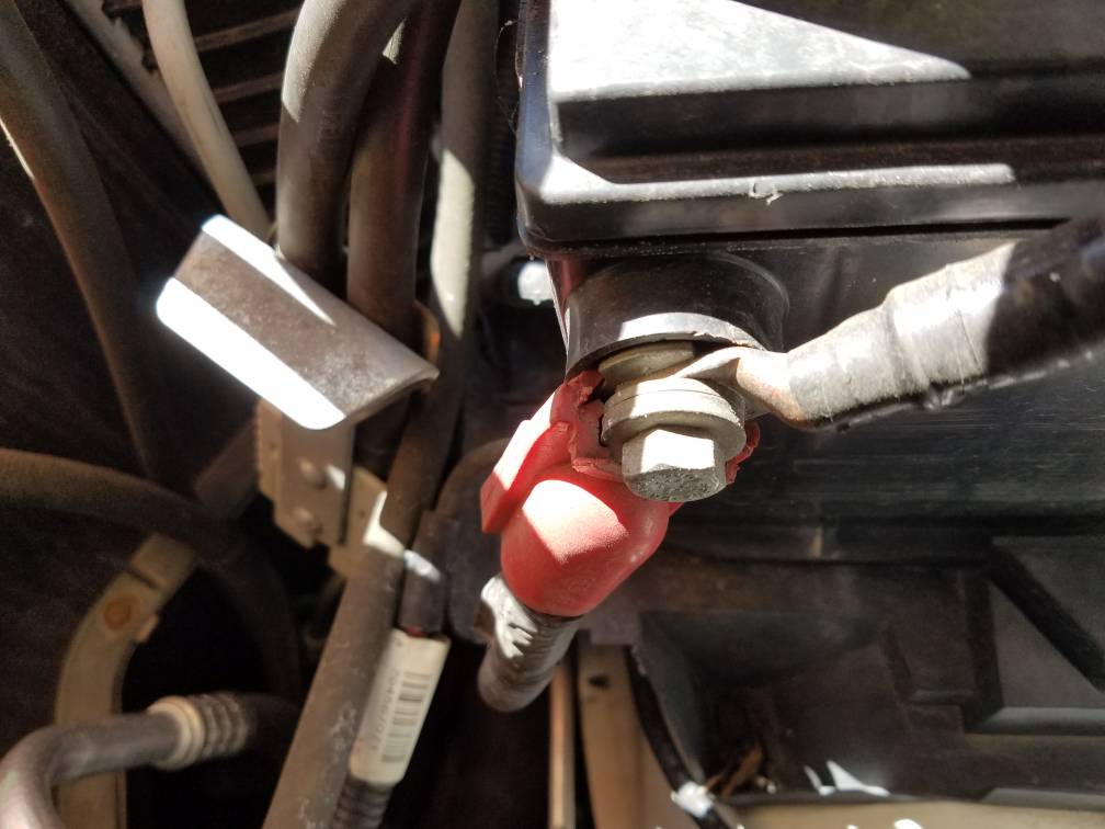

You can remove the little bolt on those and use a 3/8 bolt...

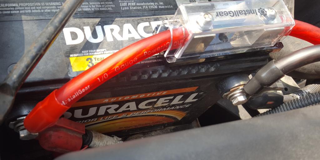

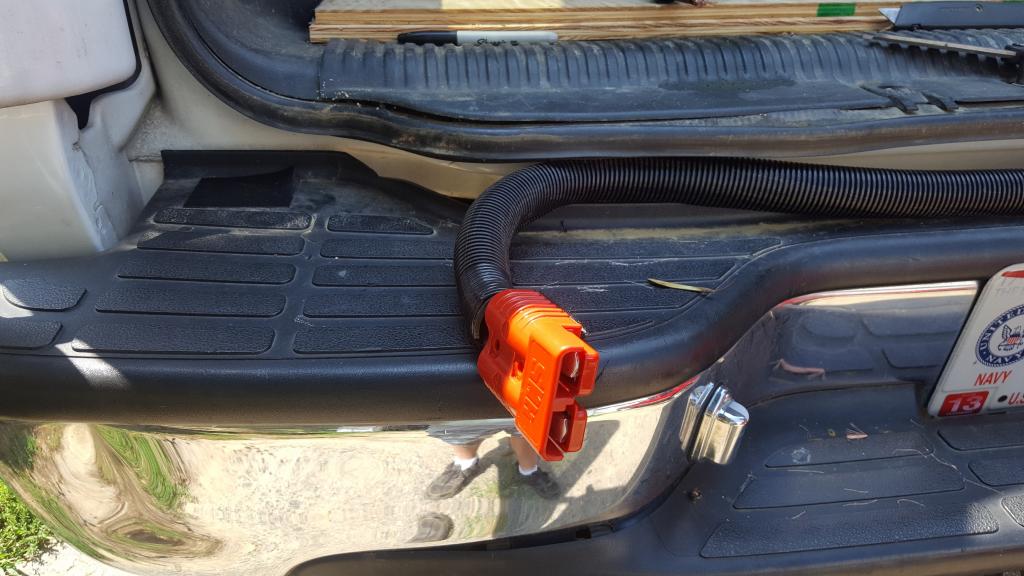

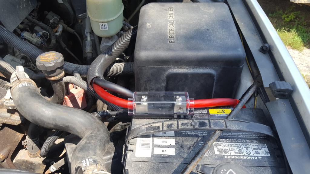

You were right, and that's exactly what I did. I had to cut the rubber insulation off the factory cable end (like you did, but more) and then it all bolted up great.
Fuse holder on the battery itself, then ran both cables straight back together, along the framerail. Out between the body and the rear bumper, and velcro'd the plug in place. With the door shut, it's really well protected and almost invisible.

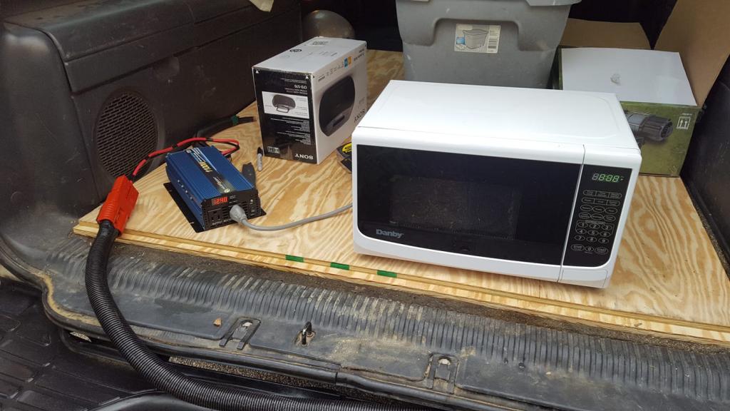

Old 08-29-2018, 07:49 PM   #8
Hot meals this weekend!
