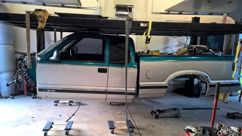

The cab comes off tonight. I will work on wiring and other interior stuff until its time to chop up the rig.

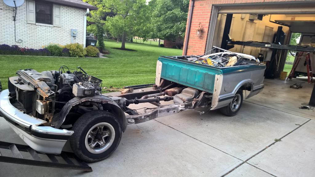

Old 05-20-2016, 11:09 AM   #18
The rest of the truck is gone. Now I can easily roll the cab around in the garage. Time to sort though some wiring and get rid of wires I dont need.

Gone, or just out of the garage?
Cut that frame in two, bolt a coupler to the back half, and sell your new "trailer" for half what you paid for the truck!
Old 05-20-2016, 06:28 PM   #21
Gone. Hit the scrap yard this morning. I got half of what I paid for the truck. $200
