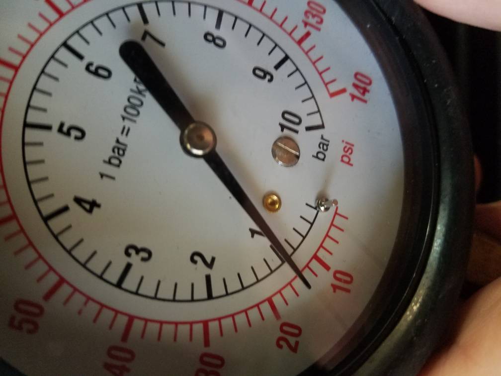

At idle semi warm. Taken at the intake port.

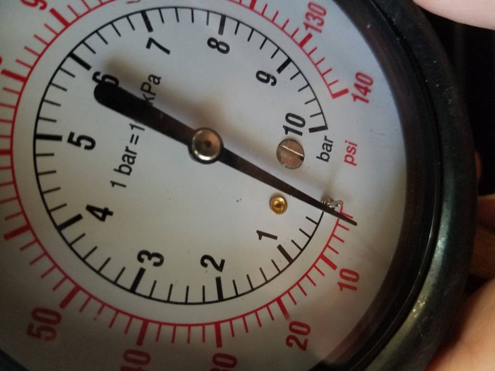

At 2000 rpms

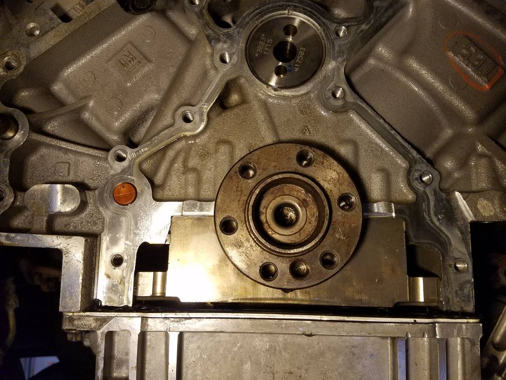

I even pressure checked the oil pan to see if it was tight.
