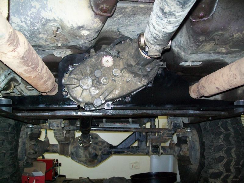

This is what I came up with to keep the t-case from twisting off the tail of my tranny again. Ended up using 2 1/2" x 3/4" bushings. This better do the trick. I'm out of extra transmissions.

Really need to connect those bottom main plates somehow... It will add tons of strength... Otherwise looks cool
Agreed.. you are still going to have a little twist.. wont be much but may be enough to brake somthing.. but it is a awesome design good work on it!

With the 1/4" skid plate tying both sides of the frame and cross member together, I wouldn't think it could move much. The brackets are bolted through the skid plate as well. I don't think I could get it mounted if they are tied together. It's real tight.

Gotcha, then just make sure what ever movement you have in your trans mount is the same amount as the transfer mount and engine mounts. I am sure you already knew that though..just want to make sure thought of it.. want you to keep it together so we can wheel together in 2012 when mines done..
