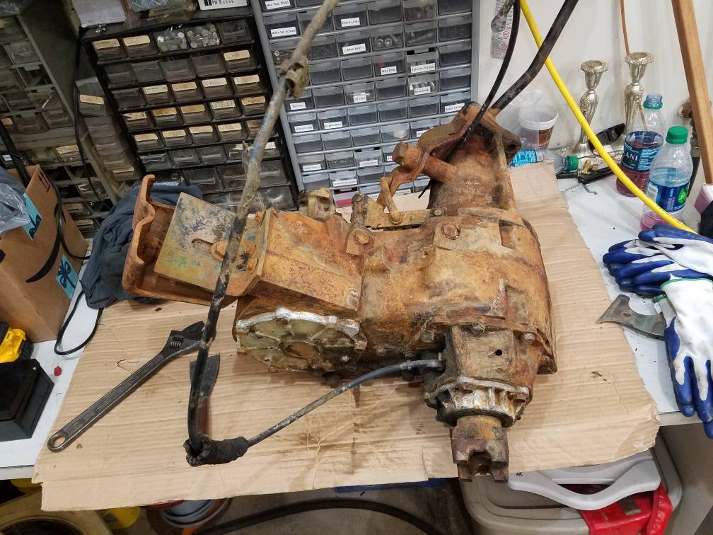

After 4 hrs of cleaning...

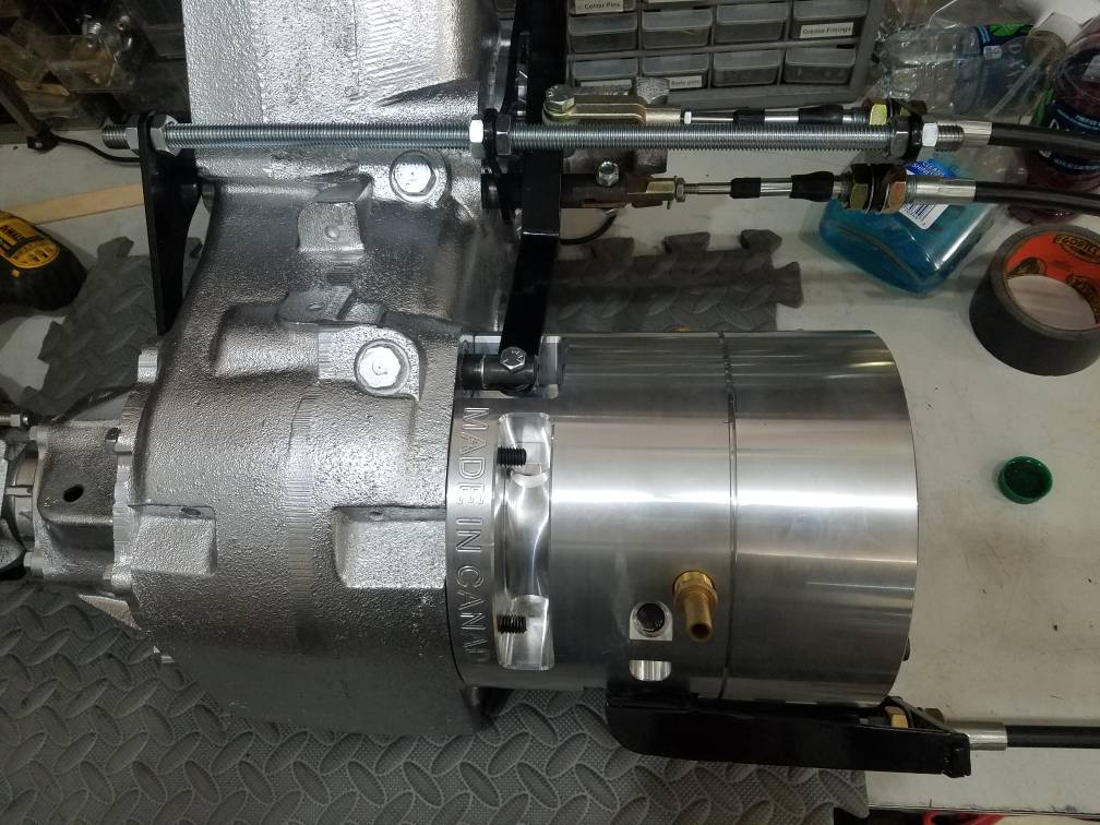

Old 11-24-2018, 01:34 PM   #104

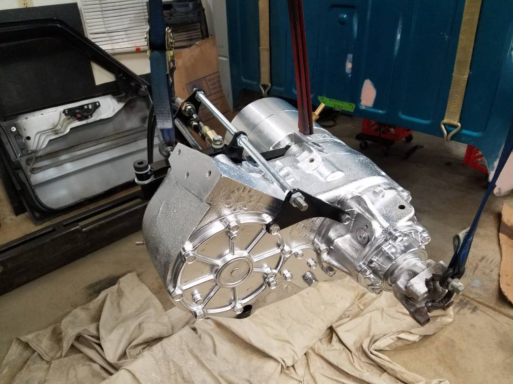

All 3 shifters hooked up.
Old 11-25-2018, 02:12 AM   #105
Holy chit, is that the same box?!?
Old 11-25-2018, 10:13 AM   #106
Wow! Very nice!
Old 11-25-2018, 01:14 PM   #107
Yes sir, after lots of cleaning and wire brushing.

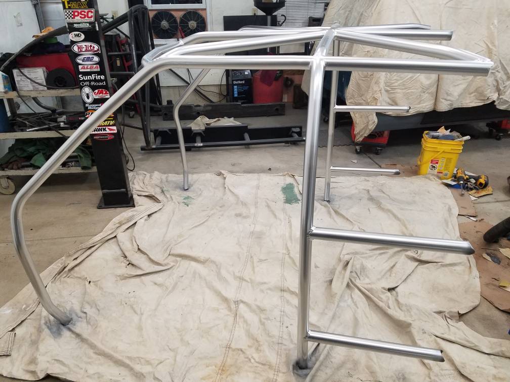

Old 12-10-2018, 03:42 PM   #112
What color is the body going to be? What color is that roll cage? I really like it!
Old 12-13-2018, 05:00 PM   #113
The body color is a surprise. The cage color is aluminum. I bought the paint today so there's no going back now. It cost $375 for the sealer and the single stage urethane paint.
Old 12-14-2018, 12:01 AM   #114
Iss secssy...

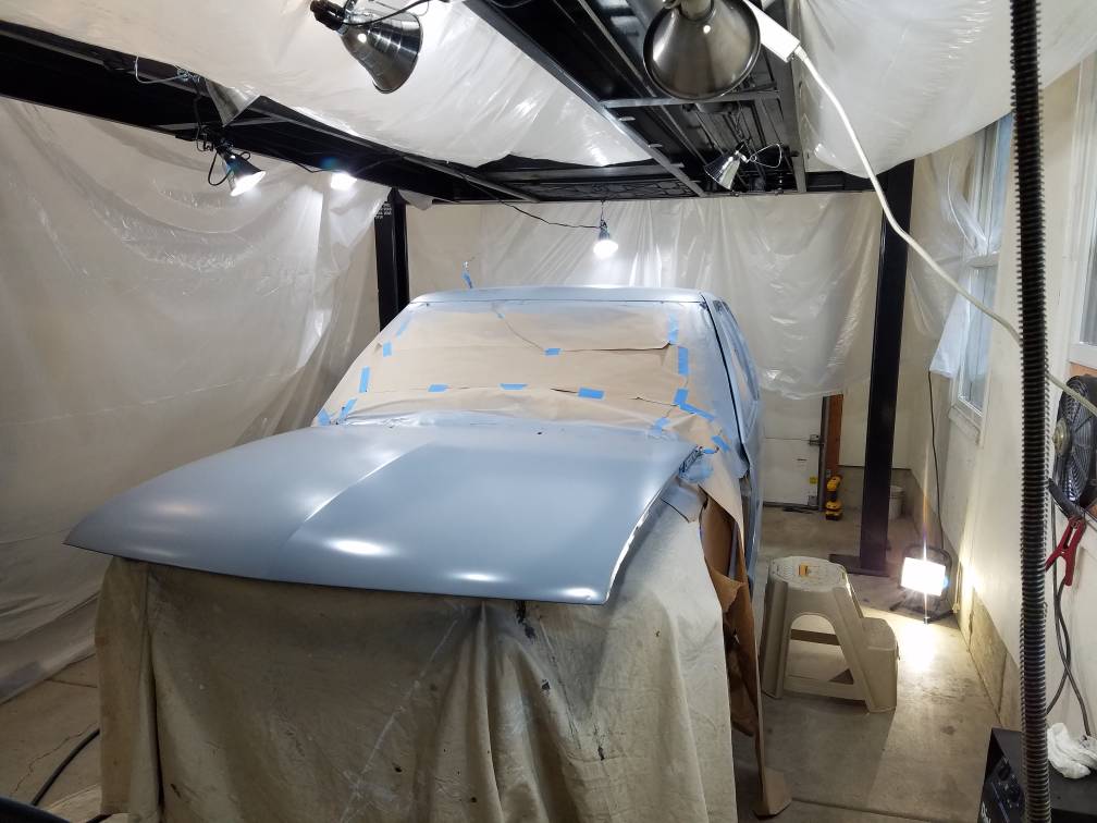

Old 12-27-2018, 03:29 PM   #117
Primer is done.Click image for larger version

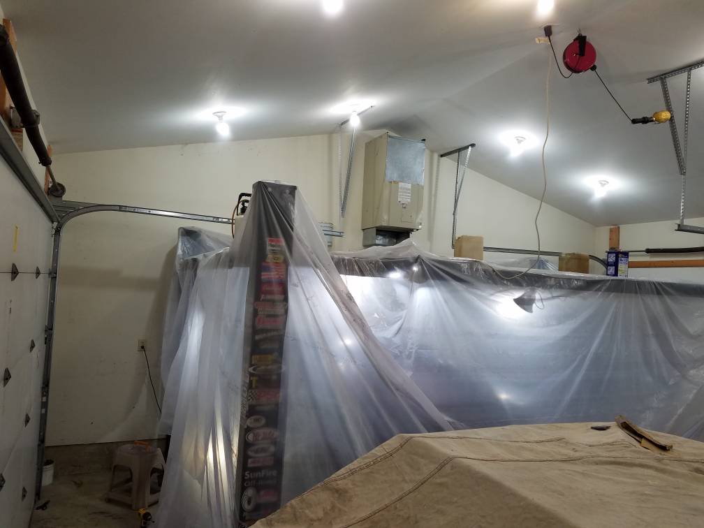

Old 12-27-2018, 05:50 PM   #118
My make shift paint booth worked out pretty good. Cranked the heat to 82 after i was done. Once i get the body back on the frame, I'll post a pic. Click image for larger version

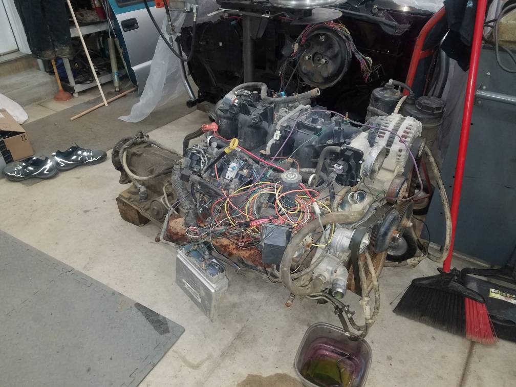

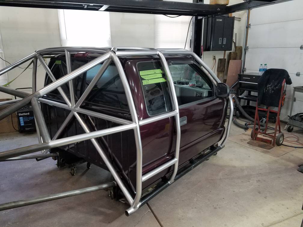

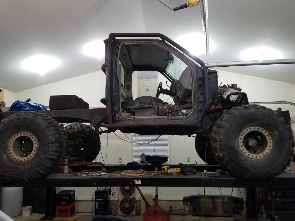

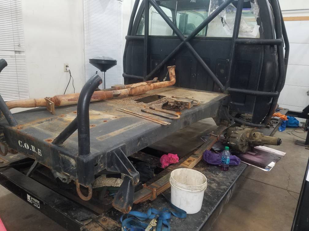

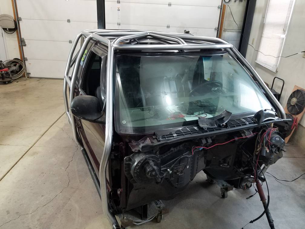

Old 12-29-2018, 11:56 PM   #119
I got the body back on the frame. I still have to weld the exo on. Brought the old rig in to tear it down and remove the drivetrain.

Old 12-30-2018, 05:49 PM   #120
Oh, that color looks GREAT. Nice choice!
Old 12-30-2018, 10:40 PM   #121
Thanks. It's dark cherry metallic. Same color as my 96 Impala SS.
Finished robbing all the usable parts off the old pig. Time to put it all back together.

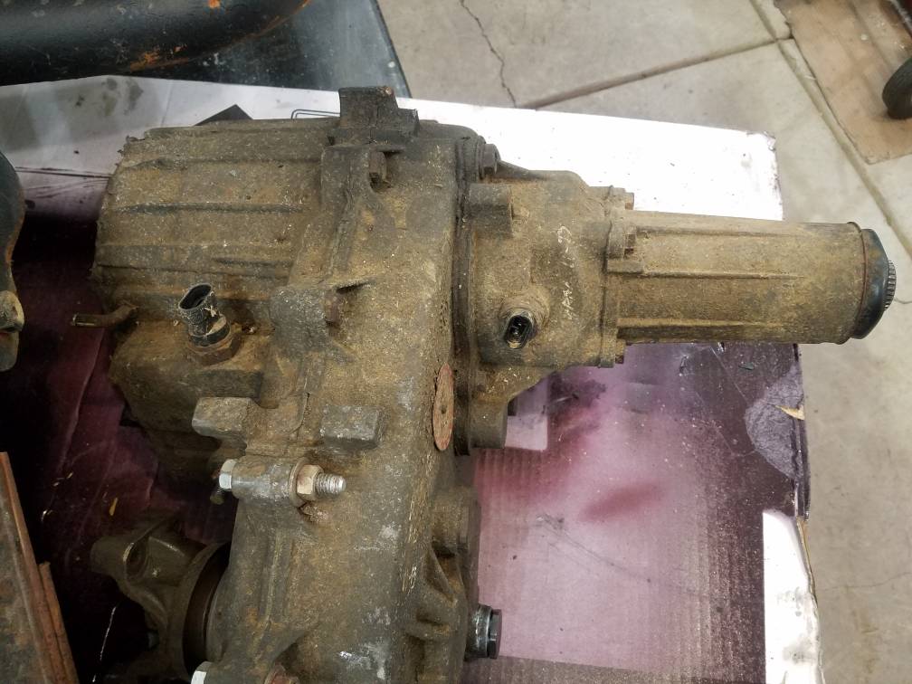

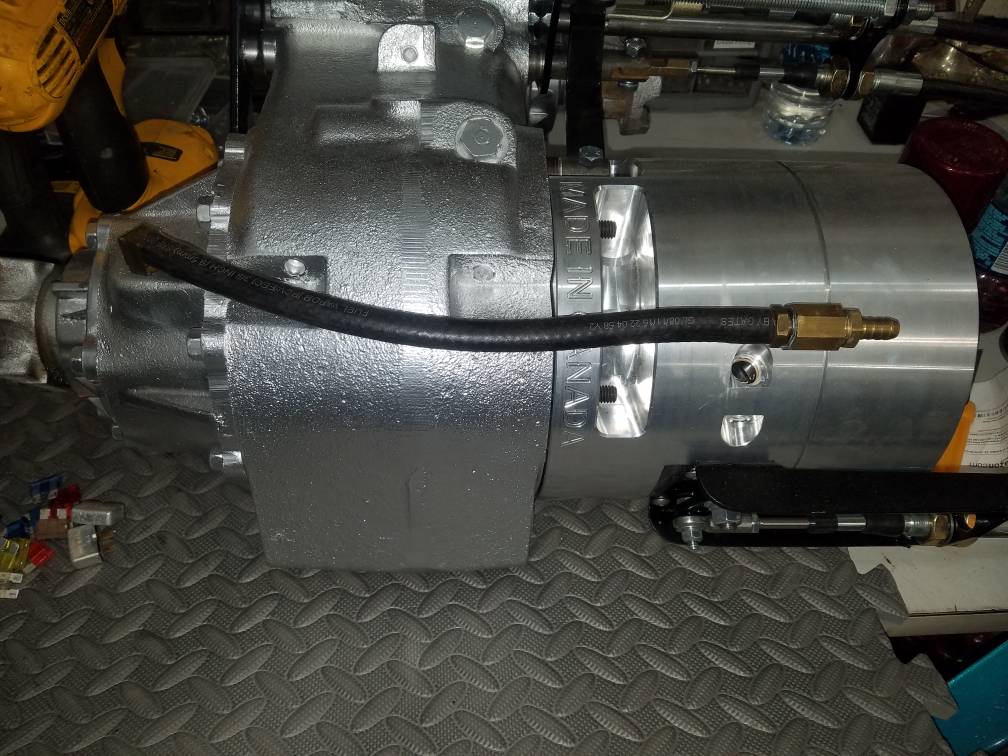

I'm only posting this info for anybody that's swapping a 241 for a 205 241 Doubler. The 241 has a long snout that basically takes up the space of the 241 Doubler. Both cases end up being 19 1/2". The big difference is it moves your transfer case farther back making your front drive shaft longer but not really affecting how long your rear drive shaft is. In my case that will make my front drive shaft angle much better than it was before. The doubler I'm using is a Northwest Fab 241 eco box.
ID:	10237Click image for larger version
