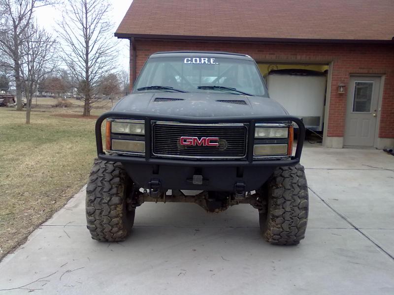

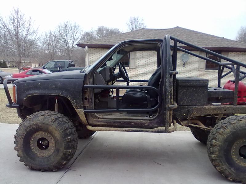

And now...
I originally planned on a full exo, but decided on just some grill protection and half an exo instead. Made some simple tube doors I can swap out when it's nice out. Let's go wheelin.

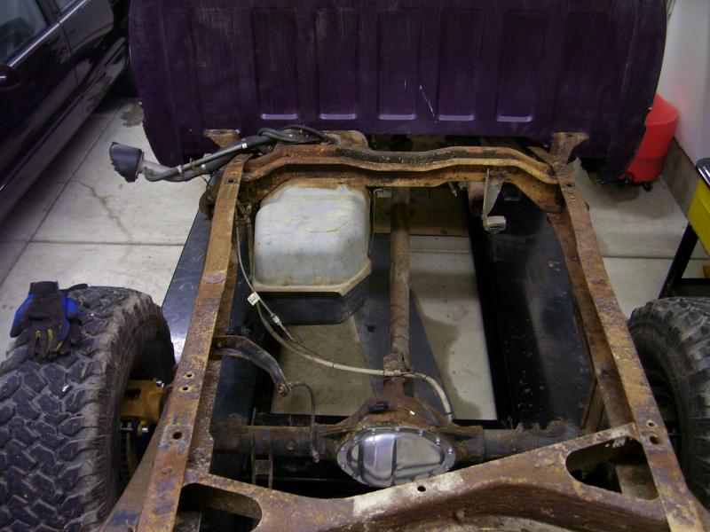

Here are some build pics as it evolved through the years.
Off with the bed.
The bed, box, and fuel cell done.

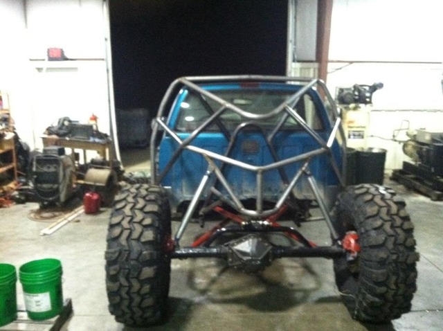

Old 05-04-2013, 09:59 PM   #5
Working on the rear cage
Cage almost done. Added some bracing and cab protection later. Still IFS at this point.

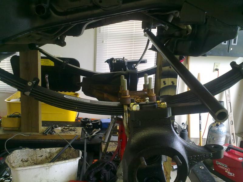

Old 05-04-2013, 10:06 PM   #6
To the front...
Swap all done.
