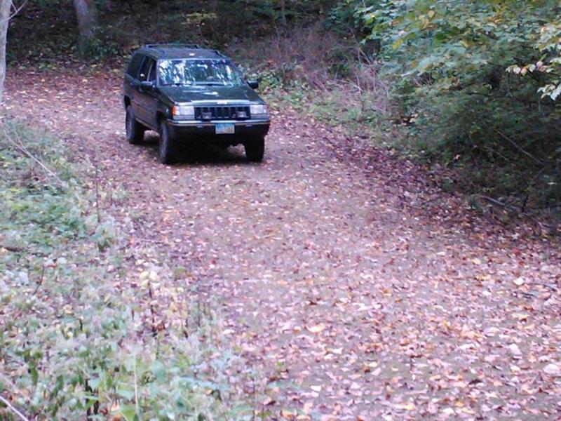

project booger
95 zj limited v8
126xxx
3 in budget boost
skyjacker 8000 shocks
rustys tie rod conversion and adjustable front tracbar
disconnected rear sway bar
5 tj rims just need tires lol
future plans
31s
tcase swap
short arms
custom front and rear bumpers with swing out
44 axle swap
sliders
bushwacker flares
custom roof rack
booger is a adventure rig being built on budget
i got her for 2 grand and 125xxx in 5 years she had only 5 k put on her so ive had alot of maintenance issues from sitting. that said im only $3300 into budget and that including purchase price so im extreamly satisfied. so far the best budget built toy ive done

Nice! I'm a sucker for cheap rigs.
Bolt on a set of 31s and run it!
Edit: Why the tcase swap? I thought the ZJ's got the same options the XJ's did, 231 and 242, neither of which is bad...
