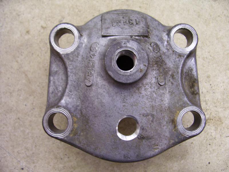

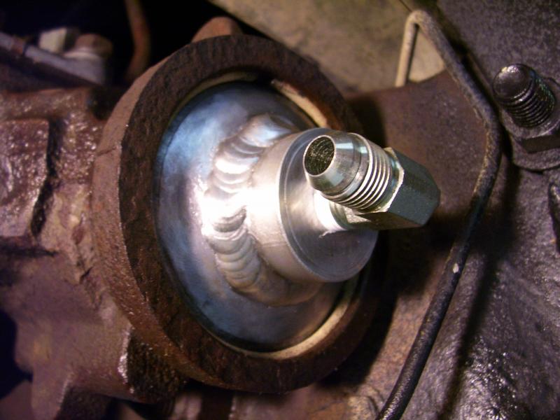

Hey Gents, been a while. I got the tires all setup with PVC inserts from Andy @TWF, and got the air soft pellets from Wally World. It definitely doesnt shake as much
But then, I'm working on hydro-assist and its not working for me.
Drilled and tap'd the box
Getting brackets tack'd in place
Supposedly I had everything correct.
Faaacccckkkk. I'm trying to bleed the system and no fluid gets down to the ram. It doesnt move at all because of this. There isnt any fluid going to the 90° adapter. The only seal I had to replace was the one on the back end of the piston. It was a 'square' ring seal over top of a rubber o-ring. I did have some blockage coming in the pressure line so I blew it out with the air compressor. When I removed the pressure line the second time to check for problems, there wasnt any fluid dripping out of it, even though the resevoir had plenty. Anybody want to come help me diagnose, I'm stumped? I would provide beer.
BillysGruff is offline   Reply With Quote

Do the the tires move at all? If no, then you might have done something wrong putting it back together.
When I tried hydro assist on mine it didn't help. The angle of the drag link made it so it couldn't push very good. That's why I went to full hydro. My box was different than yours. I tapped it differently too.

Based on your mockup in this pic I think you have the hoses switched on the ram. The box is trying to go left while the ram is trying to right.
The tires dont turn at all when its on the ground and started up, even while moving.
Thanks for confirming this. Someone else pointed that out as well. I wish that was the simple answer. Do you guys think its the box or the pump? I was told that fluid usually makes it's way down to the ram even if the pump isnt working.

Did you bleed the system? If not, jack the front end up. Then turn the wheels back and forth from lock to lock with the engine off. Keep checking the fluid level and keep it full. This may take a while because of the extra volume of the assist cylinder you need fill.
Make sure you go ahead and switch the hoses because it probably will not bleed the air out of the cylinder with them backwards.

Unfortunately, I did all those things and still nothing. I guess I'll take apart the box and see. :(

If there is no fluid coming out of one of the ports you drilled and tapped on the steering box, then there is something wrong. Either the box has some internal issue or it was drilled in the wrong spot. Mine is drilled and tapped the same way showed by 93 Krawler but also a different style box. Just to clarify:
- If you jack the front wheels off the ground they won't turn side to side at all?
- Is this with the ram installed? If the hoses are backwards the ram is fighting the steering box. If the ram is not installed (just hanging) and the wheels won't turn then look at the box.
- If you disconnect the steering box from the pitman arm or drag link, can you turn it?
For bleeding I had to have the ram connected so when I turned the steering wheel it forced it in and out. Tried with it just hanging and it wouldn't bleed without forcing the cylinder to move some other way. I've also never had any luck bleeding mine (hydro assist and hydro boost) with the engine off. It will just burp fluid out the remote reservoir forever, or at least until my forearms can't take it anymore and it is never bled. I just fill up the reservoir, start the engine, and turn the wheels lock to lock once or twice. Refill the reservoir and do it over a couple times. Once the reservoir level stays fairly constant I will start it up and turn lock to lock many times. Oh, if hydro boost brakes you need to pump the brakes several times after you turn the motor off each time. There is an accumulator in the brake system (so you still have some power brakes if the engine dies) that you need to release the pressure in order to get it to bleed.
1. The wheels turn fine right now that its on jackstands. There is 0 power steering while running and attempting to turn with the wheels on the ground.
2. Yeah, tried bleeding with everything connected, even started the motor and did lock-lock a bunch.
3. Steering box turns fine with everything connected and on jackstands. Its gotta be fluid flow not assisting.
I'm confused as to why theres no fluid going to the box. Its the first stop for fluid after the pump. Also, I think only the HD's got the hydro brakes.
Dude, you are the man. This helped me so much. You helped me remember that these things arent Sally Prius', Saturn Ion's, or 4cyl Escapes. You have to give it that extra umph to get it go. Thats exactly what I did. I gave it gas while turning and did hit the brakes a couple times after I turned it off. Its so easy to turn the steering wheel now with the truck running. I can do it with one finger. The lines I ran did have to be flipped, so thanks for that. Also, I didnt mention that I drilled the pressure line fitting in the pump to 5/32".

Ok, I finally did it right. I bought some Loctite hydraulic sealant and wrapped the fittings about 10 times with tape. I was able to bleed and drive it around and it doesnt leak! I also bought the plastic line separators. I plan to make either a small tab or maybe even a small skid plate to protect the hydro lines. i also cranked on the pressure fitting at the pump because it was leaking, too.
