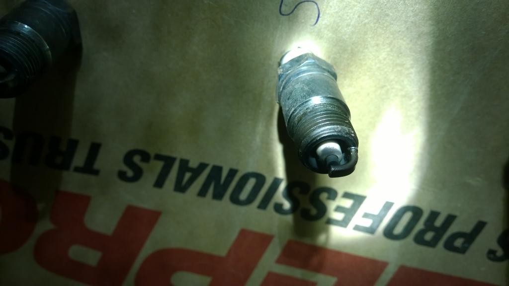

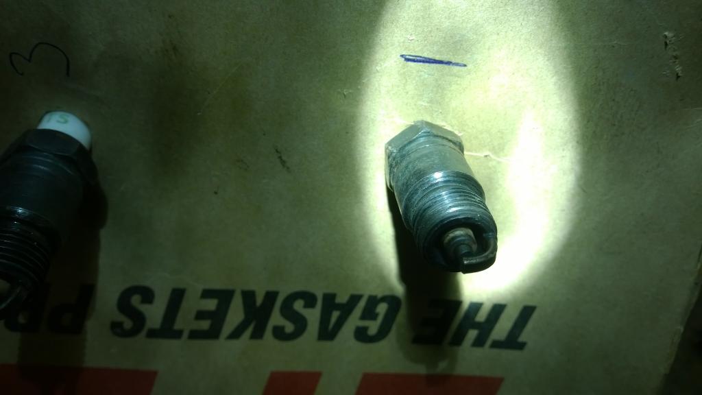

Ok, so my rig runs rich. It smells rich, and the plugs say the same. It ran better before the cam and multi-port swap. I went through the EFI a few weeks ago and swapped out some parts with spares I had. Nothing really seemed to help. I had a scanner hooked up to see how everything was running. I noticed it took a long time for the system to show closed loop, and only did when I gave it some gas. Then it would go to open loop again after a few minutes. It was real cold out that day. I know running headers and free flowing exhaust can make the O2 sensor read cold, but will a colder thermostat make it even worse. The rig always runs cold because of the massive radiator and the 180 t stat I run. Stock is 195 degrees. It makes sense that a 195 t stat would make the exhaust gasses a little hotter. I'm going to put a 195 stat back in it to see if it helps. If not, I'll have to use a heated 4 wire O2 sensor instead of the 2 wire stock one.
I use stock AC plugs. They have one ride on them. Before the hangover run, I took them out and cleaned them so I could see if it was running better. They are still black. Not terrible, but not good. I'm thinking about going a step up in heat range to see if that helps. I think the cam was a mistake, and is the cause of my headache. If none of this works, then I'll be putting on propane.

Old 01-05-2015, 07:59 AM   #16
If it keeps going into open loop that could definitely cause it to run rich...basically like having the choke on. Probably wouldn't be a bad idea to go ahead and do the 4 wire heated O2 sensor also.
Do you know what type of fuel pressure you are getting?
Old 01-05-2015, 12:00 PM   #17
Kevin I would put a hotter Thermostat in it, sounds like computer thinks it's not warm enough so it's running rich.
Old 01-05-2015, 12:22 PM   #18
I don't remember the numbers, but they were within Edelbrocks specs.
Edelbrock says to use a 195 stat for best performance. Maybe the multi-port is pickier than the TBI was. The TBI ran ok with the 180 in it.
