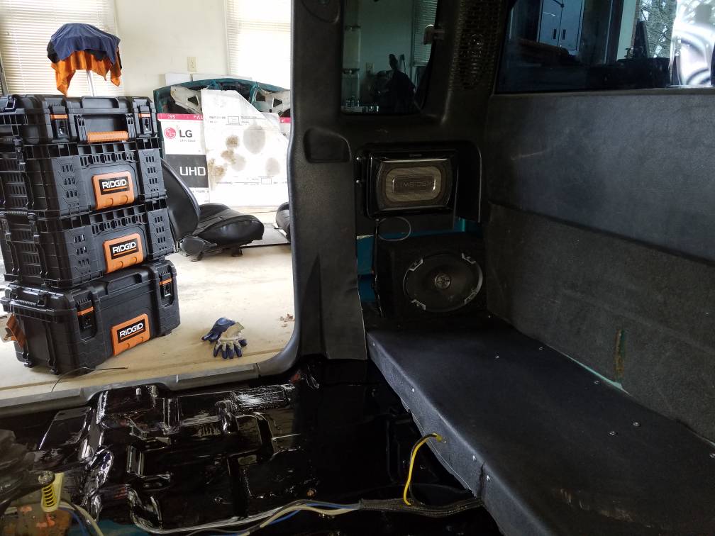

My stereo equipment fits perfectly where the jump seats were.

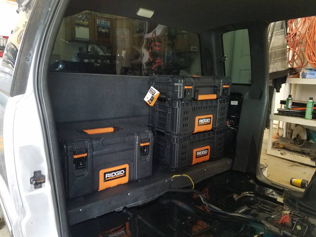

These interlocking boxes and tool box worked out great.

Those toolboxes are awesome. DoWorkXJ (Justin) has a set, I had them at my house for a few days and they looked very nice.
Interested to see how you are going to lock the boxes into place. are you planning on using the built in "interlocking" function of the boxes to hold them in without racket straps or bungee cords?

I will bolt the 1st crate to the floor, and also use a ratchet strap to hold the top boxes in place. I haven't decided how to hold the toolbox down yet. I will definitely make sure they are secure in case of a rollover.

looking great and a lot of progress for sure. I went out a week later and bought 2 of the top boxes. All my tools fit in these with exception of my deep wells. They are really heavy per box...like I believe 75 to 100 lbs each. The interlocks are great and I am securing with straps and tie down points.

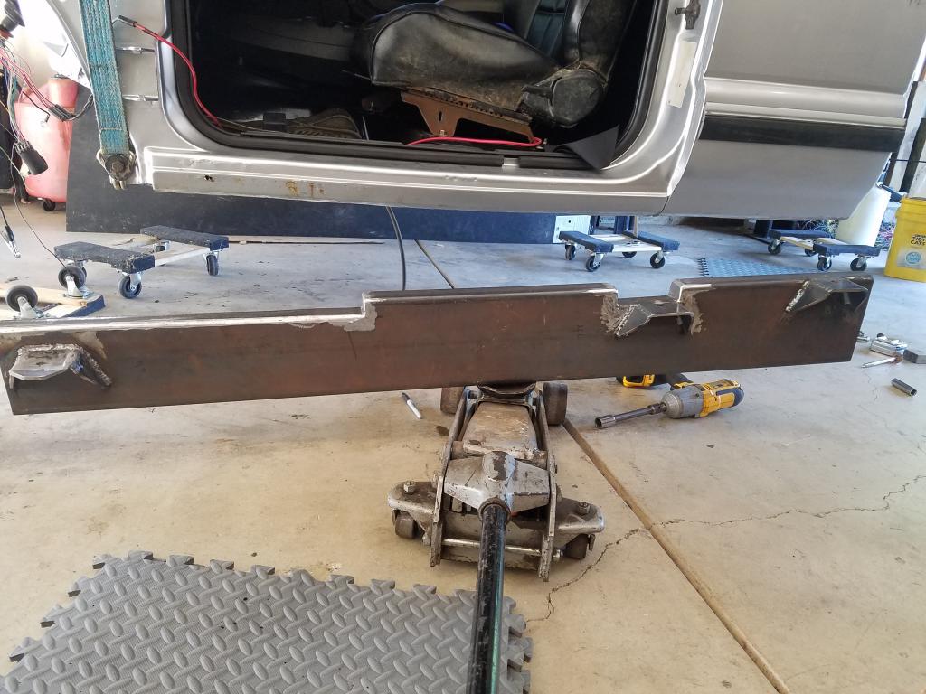

I didn't like the way the frame was hanging down so I notched it to fit the cab better. Gained 2 3/8" by doing it. That will subtract from the total height. It was a lot of work, but well worth it. Still got the other side to do.

Old 07-19-2018, 05:44 PM   #50
Frame rails look great Kevin. That height reduction will also help lower your center of gravity.
