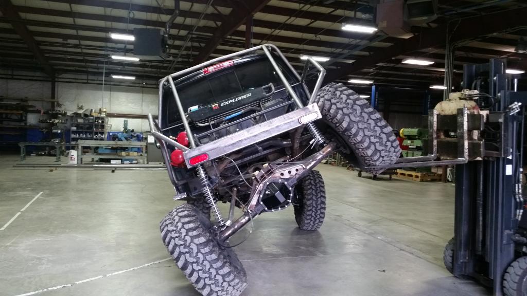

Moved 1 foot forward and 1 foot backward for the 1st time in 4 months. Few things have changed while in the process of building. Went with coilovers all the way around and did not cut as much off of the lower doors as I was planning on doing. Going to weigh the vehicle next week. Only a few major things that are keeping it off the trails currently. Front driveshaft needs to be lengthened 1.9", finish welding in the links points, add bed skins,
recovery gear, spare tire etc...

Looking at where I thought the build would go on my 1st page of this thread.
My 5000 lb. goal will be tough to keep.
Ran Fox 2.0's all the way around.
PSC full hydro with modded stock pump and custom pulley.
4 link with track bar up front but dual triangulated rear.
Exo-caged.
12000 lb winch
1410 rear driveshaft
