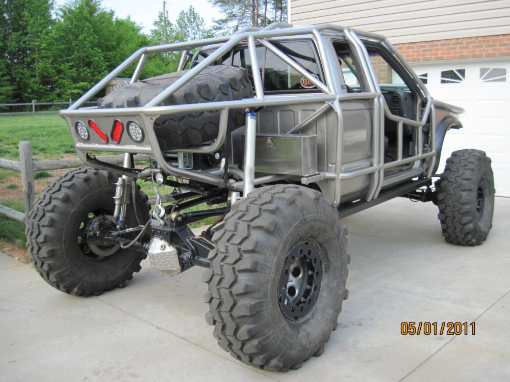

I've found a lot of ext cab s10 truggy's online that I like so that's the route I'm going. I really like this one except I would chop the front off and tube it, and lose the spare tire.

That's awesome.
You're keeping doors n windows right?
Old 02-12-2016, 03:10 PM   #183
Oh yeah. Gotta have doors.

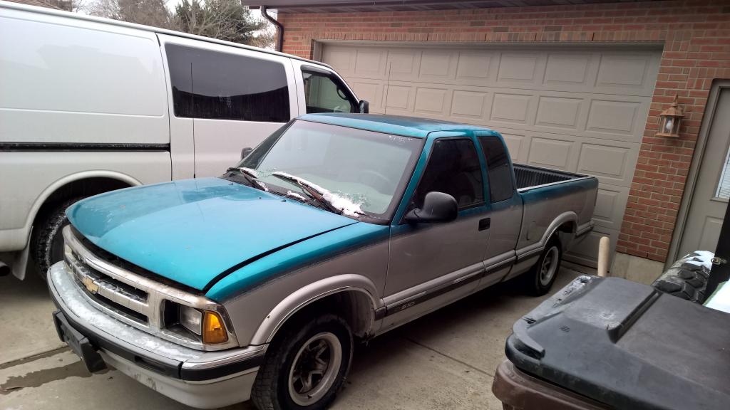

Going tomorrow to look at this one. http://cincinnati.craigslist.org/cto/5437108199.html
If the rust isn't too bad, I'll grab it. Looks like I'll be keeping that other 5.3 for mock up purposes. It already has a 4l60e, so all I need is a tcase from upull and I'll be set. I figure I can get some pipe to mock up the axles. I should be able to build most of it before I need the parts off the 93. Don't want to miss any wheelin trips...

It's mine now... What a turd. Lol

Thanks. Got it for $400, and it looks like a $400 car. It needs some love on the inside for sure... I think someone lived in it. A trip to you pull will fix that. Once I rip the seats and carpet out it will look a lot better. Frame is in good shape, body isn't bad. There is a little rust on the cab corner, but overall, in good shape for a off-road rig.
