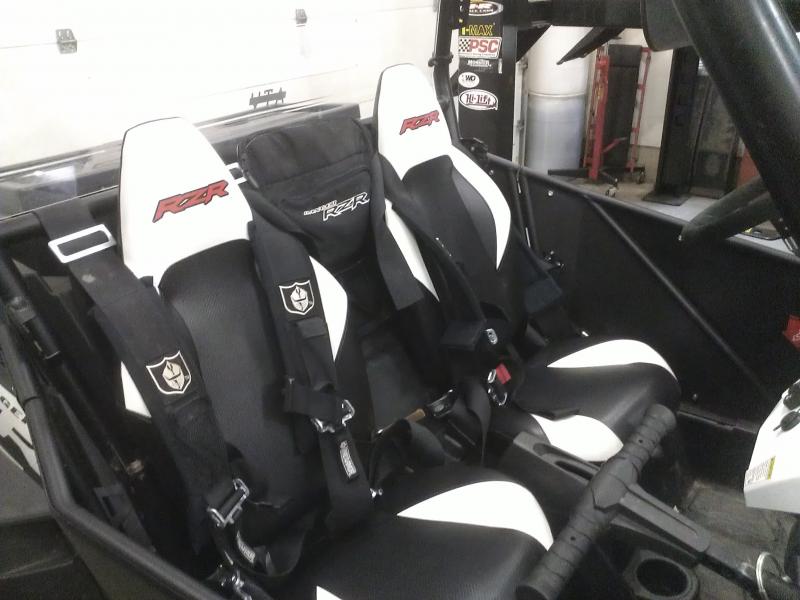

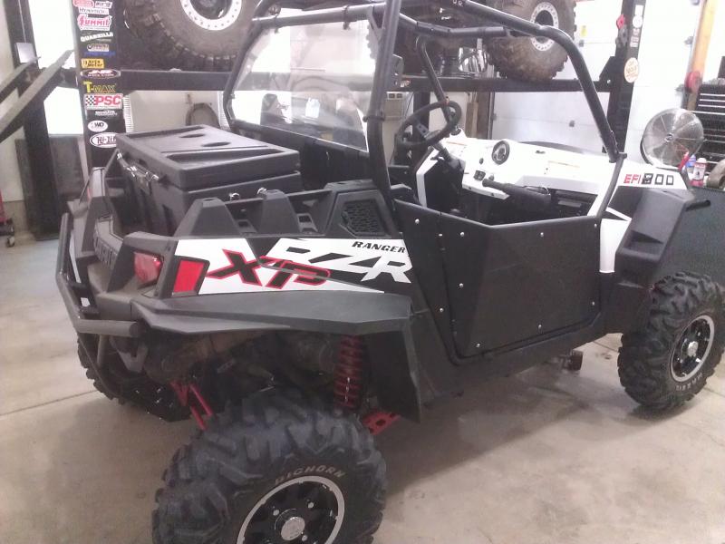

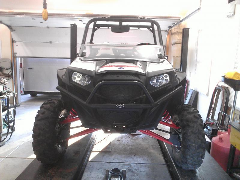

I figured I would document my build progress here. I bought it with front and rear bumpers, doors, front windshield, rear dust shield, rear view mirror, aftermarket steering wheel, rear cargo box, and 5 point harnesses.

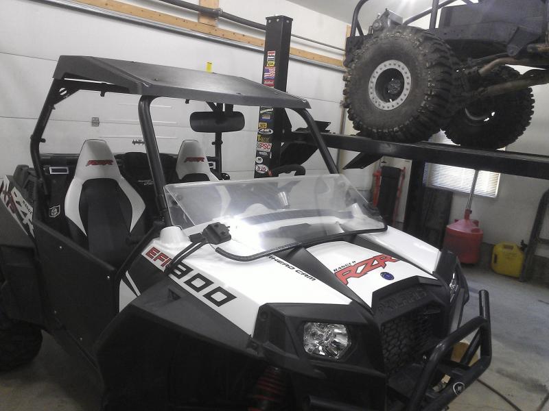

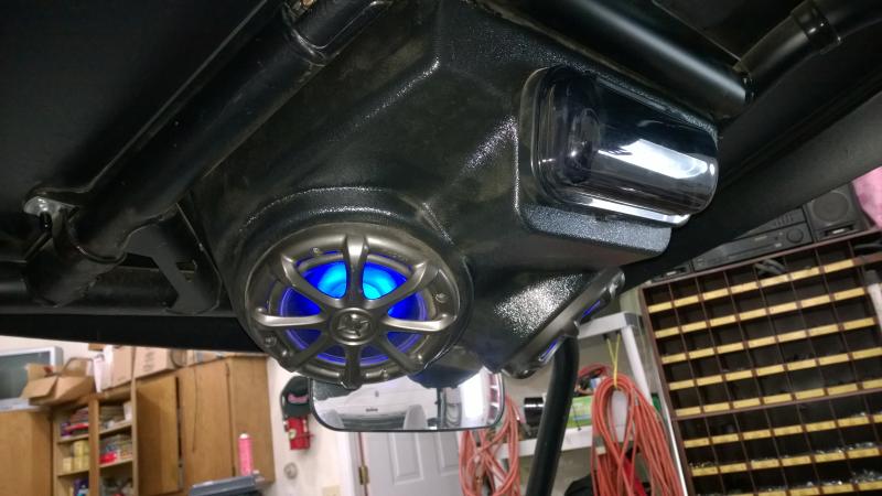

I bought a full roof and an empty stereo pod so I could build my own system.

I'm waiting on the stereo parts to come in.
For anyone using the Cooter Brown roof and a flip down windshield, be aware that the windshield will not shut against the bars as it shuts against the roof. The only issue this may cause is if it's raining, the water might roll in between the roof and the shield. You could always pop out the two mounting screws and put the shield under the roof if it is raining a lot. You would not be able to fold the shield out unless you put it back the way it was.

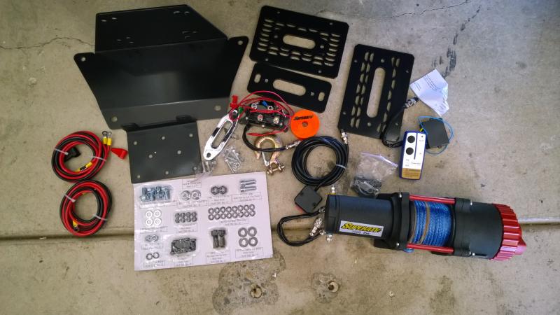

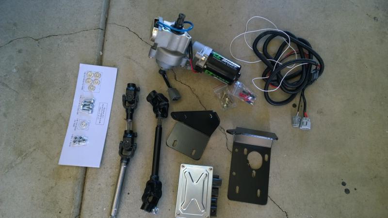

I ordered a new winch, and power steering. It will be here today. Should have it on tomorrow. I still need to upgrade the trailing arms and a stronger skid plate under the engine.
Old 07-22-2014, 12:58 PM   #2
The power steering is killer. Glad I went ahead and put it on.

The winch tucks in nicely so you really can't see it. All you see is the hook.

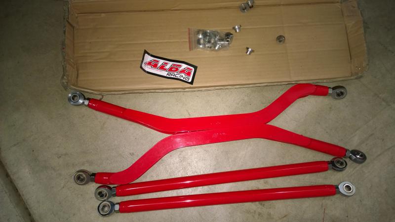

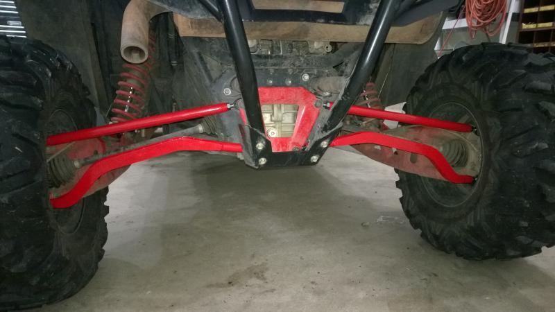

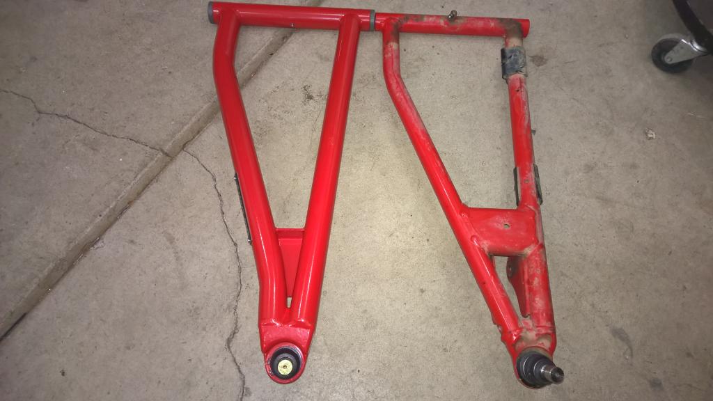

One of the rear arms was bent, so I put some high clearance arms on.

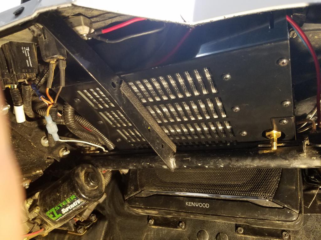

Put in a Kenwood marine stereo, and some 6" LED Kickers.

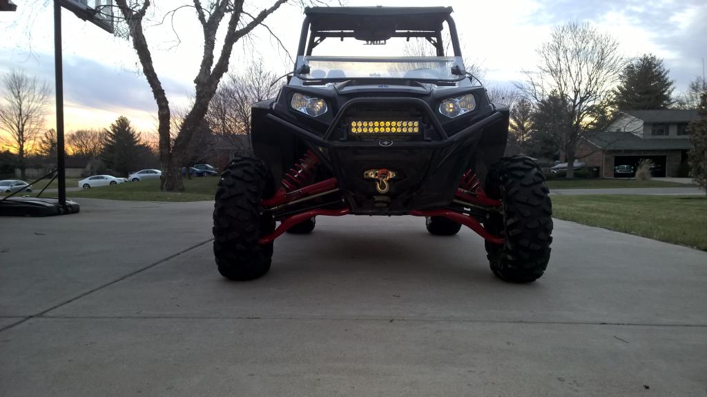

Did some more updates. I found one of the front a-arms bent so I put on some high clearance arms. The stocks ones are cheap compared to the new ones. Also added a little LED bar to the front.

Old 05-06-2015, 04:44 PM   #7
What brand are the arms , I've got a tweaked one and have been looking for something new.
Old 05-06-2015, 07:57 PM   #8
These are the ones from super ATV. They move the axle 1.5" forward, so you can run a 30" tire without a lift. They have a lifetime warranty, and come with all new ball joints. The only thing took some time was adjusting the camber. I like them. They are beefy.

You'll love the 12" led. I find I use it more than my 30" or HIDs.
Old 05-07-2015, 05:55 PM   #10
Yeah, it should do the job. I have it wired to my brights. I have a 32" led bar on my rig. That sucker is like the sun.

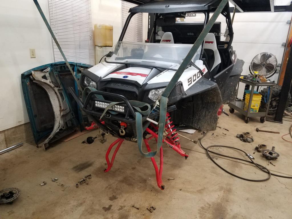

I bought a couple el cheapo shafts to try out. I'm putting one front and one rear on to see how long they last. I'll keep the factory ones as spares. They say they're 4340 steel, so hopefully they are stronger the OEM. The rear shaft was 1/8 thicker the OEM. We'll see...
https://www.amazon.com/gp/product/B0...?ie=UTF8&psc=1
I couldn't get the axles out of the case so I hit google to see why. Saw a video of a guy trying to get one out. It was rusted in there. I didn't know they weren't sealed inside and there's no seal to keep water out. So I got out some WD industrial and sprayed all 4 axles where they enter the case and let them soak all night. Sprayed them again next day and with a little pry and pull, they came out. I recommend spraying them often to keep them from rusting. Changing a rusty one on the trail would suck. I used anti seize on the new ones.
I had been noticing some play in the wheel bearings for a while. After I took everything off the play in the bearing was scary. I guess the caliper toned the play down some. I have 4 new ones on the way. I found a cool greaser for them too. This is something I want to add to my yearly maintenance routine.

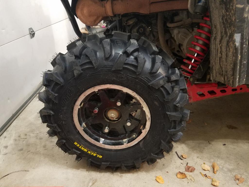

Got some new tires too. Same size, just more aggressive. 27" ITP Blackwater

Old 12-12-2016, 02:39 PM   #16
Figured you would be getting new tires after the DTOR trip. The Blackwaters are at the top of my list also.
Found out the hard way, they run small! Mine came with 26" Bighorns, the 27" Blackwaters are a tad smaller. I hear Bighorns run big. I would've got 28's if they had them in my rim size. I have 2 new 26x11x12 Blackwaters in my garage. What size do you need?

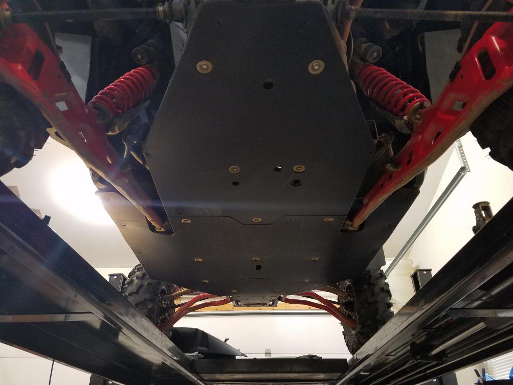

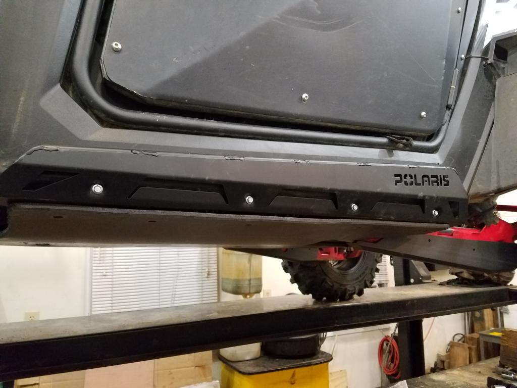

Put on some very needed belly, trailing arm, and rocker protection.
The 1/2" UHMW skid should do the job. Probably should've put the trailing arm guards on a long time ago. They are hit!!

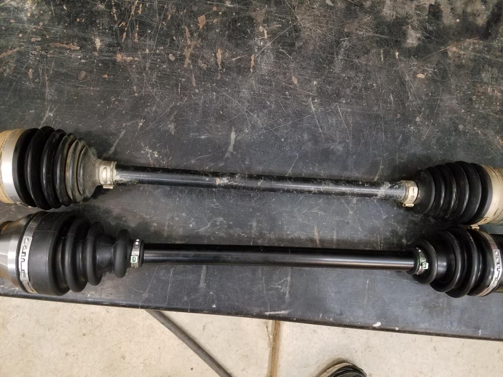

Somehow i managed to bend the front driver axle. The center shaft has a nice crown now. It's one of the new ones i put on in June. Has a 1 year warranty, so I'll see if it's covered.
I always thought the joint would fail, not the shaft bending. Supposedly it's cro-moly

For me it has always been the CV joints that explode. Have yet to trash a shaft.
