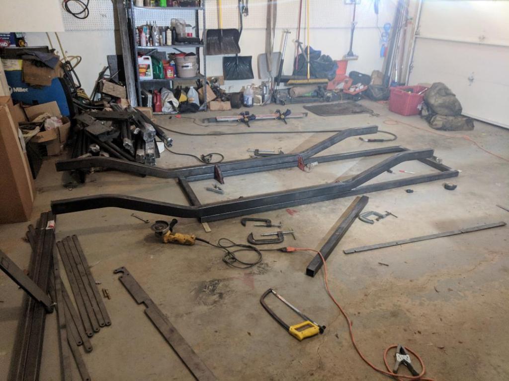

Picture of the build platform and the framerails

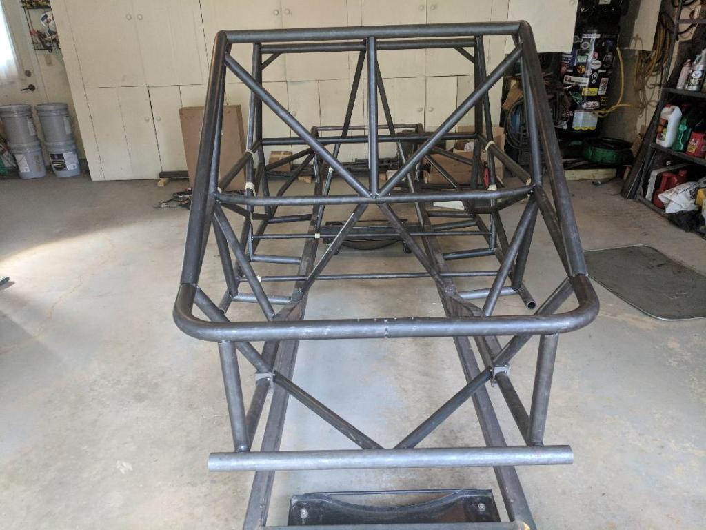

picture of the framerails and the JIG (mostly assembled) that helps align and locate the tubes during assemlby.

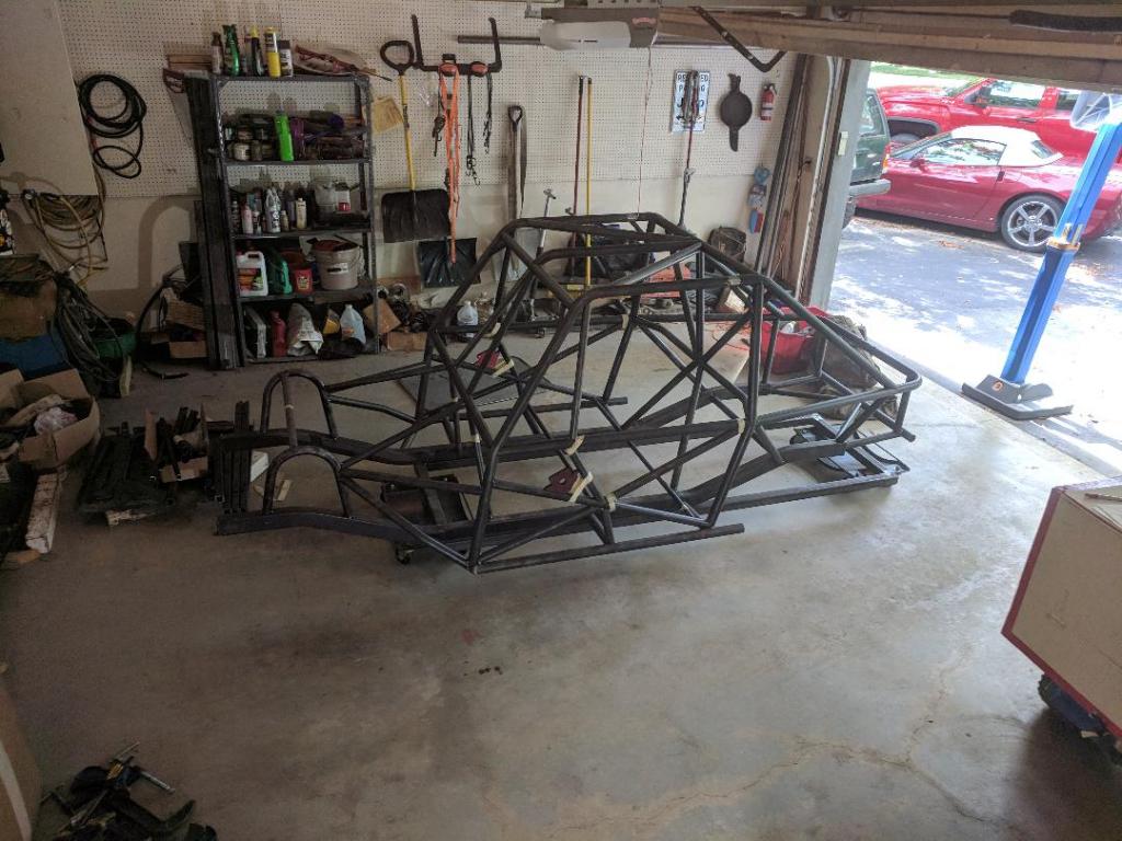

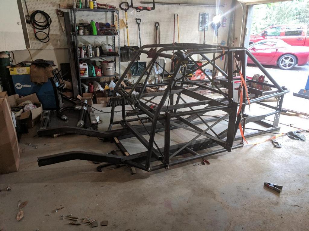

Picture of the chassis with the Jig

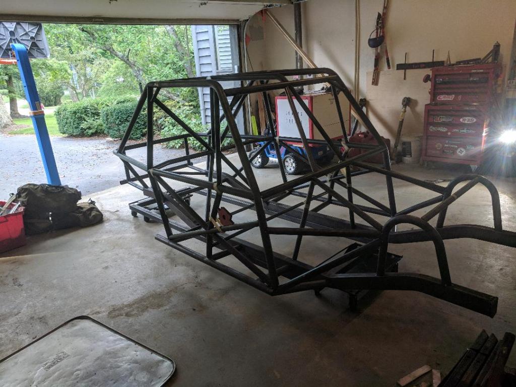

Picture of the chassis Jig removed (Missing the rear shock hoops, vertical dash supports and subframe)

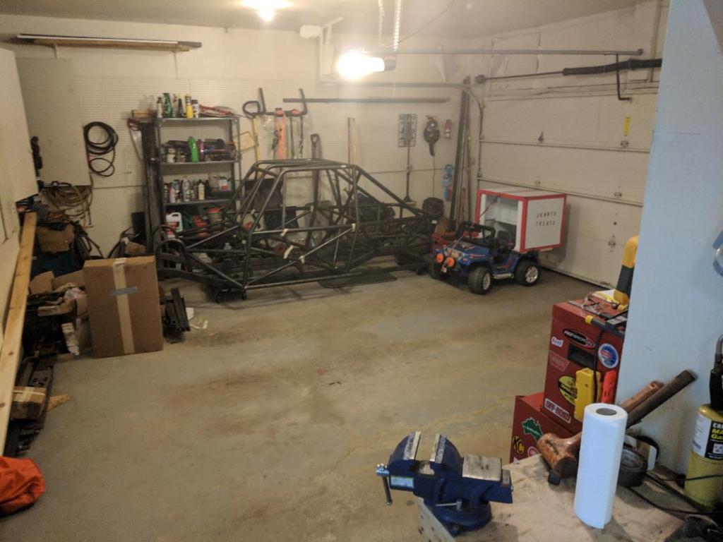

Chassis tucked away in the garage until I get a chance to work on it again.
