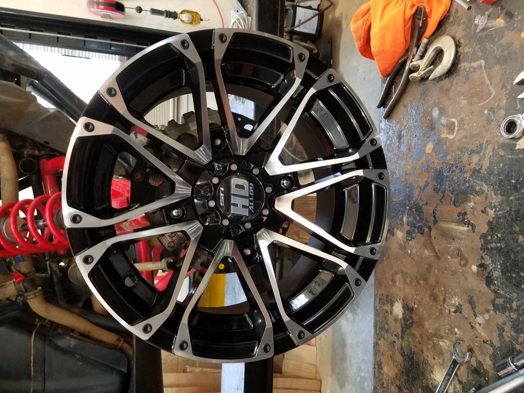

I am going to sell my old tires and the rims. I ordered 30x10x14 Carnivores today. Supposed to be in around March 29th. Pic of my new rims.

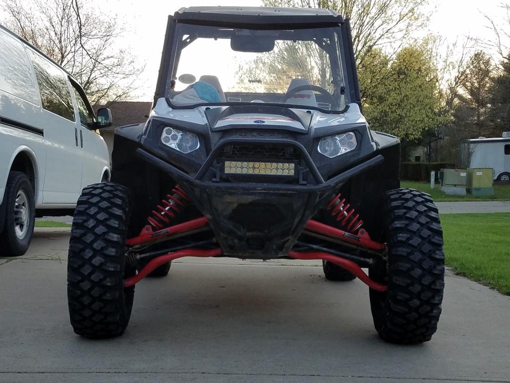

Well, the Carnivores are still on back order, and for who knows how long. So I cancelled them and got the 30" Pro armor crawler XG's. I read online about people saying they run small, the 30 measures 29, but that's not what I found. At 10 psi, they measure 29 7/8. We'll see how my axles hold up at rush.

Old 04-10-2017, 09:33 PM   #34
The new tires are killer in the mud and rocks. I took out a front and rear axle during the testing process. Oh well... Time for some rhino axles.
