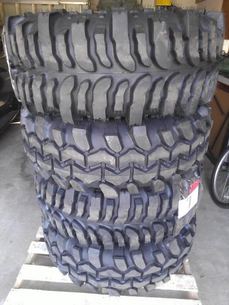

Got my tires today.

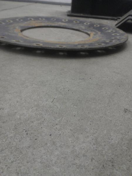

Get my new rock rings tomorrow. These things are done...

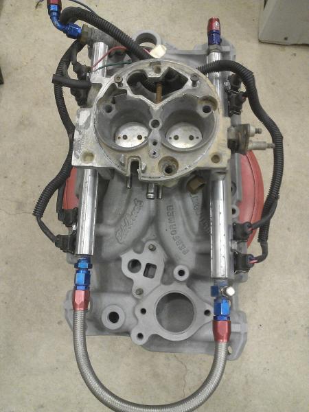

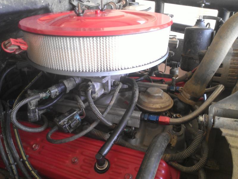

Got my multi-port injection and cam in.

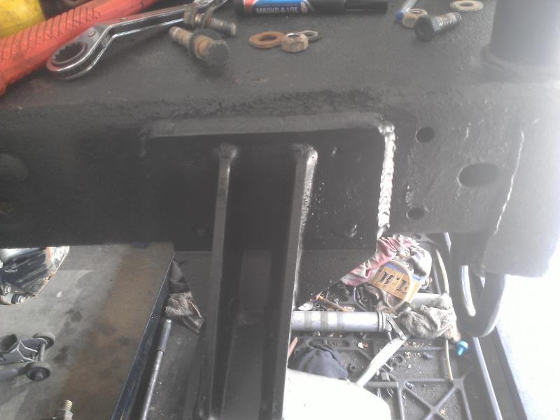

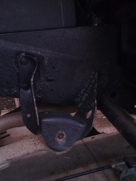

Also plated, gusseted, and welded my spring hangers on so I don't tear one off like I did in Lions den last year.
The hanger after Lions den and a trail fix so I could keep going.

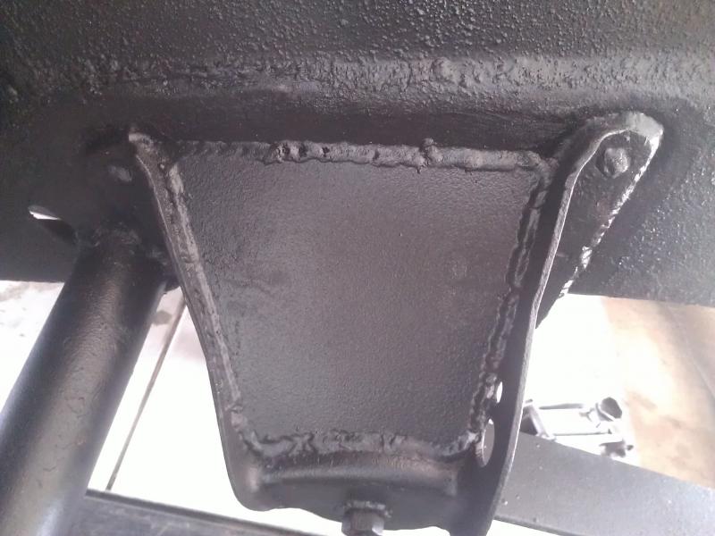

The back is plated and has gussets to the frame.
I'm ready for Lions den again.
