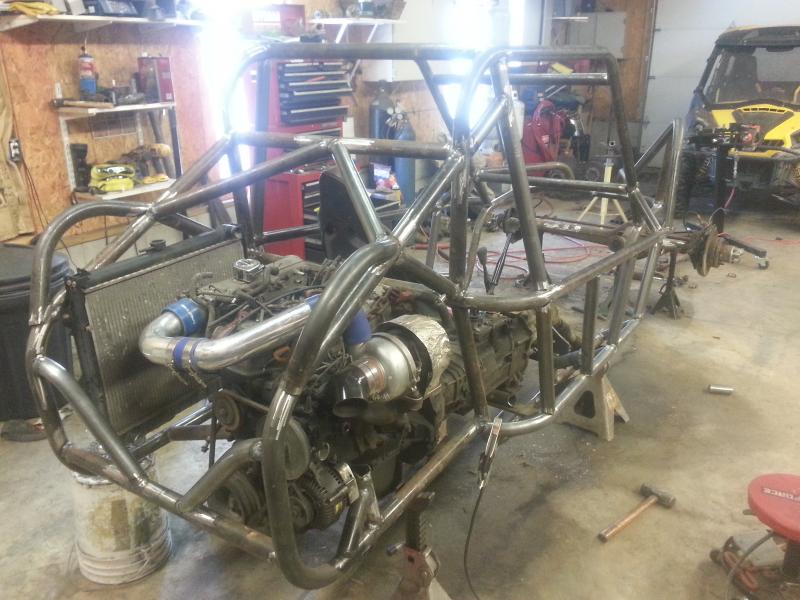

rear engine yota
so got bored and startd another buggy

cool design... i have a friend with a rear engine single seat yota buggy... the thing goes everywhere...
I'd like to built something like either of these but with a little turbo diesel...
Old 01-29-2014, 03:42 PM   #3
yeah that perdy cool! there enough room in chassis for a sbc if wanted, but i had most parts laying around garage and got sum 38 sx for tars. think i got 7 sticks in this chassis

Excuse my ignorance, but doesn't the engine (and the tranny, tcase, and driveshafts) spin the wrong way? Is there a reversing gear somewhere in the drivetrain?
Old 01-29-2014, 08:04 PM   #7
flip thirds 180 is my plan. shooting for bout 110" wheelbase and sum 4.7 gears in tcase to help the 22re
Old 01-29-2014, 08:10 PM   #8
Oh, cool. Didn't know you could do that.
Learnt somethin! Thanks!

what turbo setup are you going with derek?
Old 01-29-2014, 08:46 PM   #11
That will never work! My buddies best friends sisters fiancées dad said yota thirds won't work upside down... U shoulda bought a jeep yj

Jordan it has a air research t4 with 8psi wastegate rite now, wanted to giv it sum motovation! Humpy that sounds like a jeeper fo sho! extreme did the low budget pimpin style chassis, which is what i thinkin on building next, using honda motor and transaxle or mayb ecotec,but that b after i sell this
Old 01-30-2014, 11:27 AM   #15
I want a trans axle single seater with. 3.8 motor... Basically a big ass go kart lol
Old 01-30-2014, 11:30 AM   #16
i thought that other day, l67 with auto and flipped yota diffs, mofawker be scary fast!

they can be flipped in the housing, how ever not recommend for i
high speed. the oil slinger is in wrong location.

Twisted looks like it would be hard to shift the gears facing that way!
but hey you always was a little twisted..lol
Old 02-01-2014, 10:17 AM   #19
nah just unique shift pattern! all need is 3rd n reverse
Old 02-01-2014, 10:29 AM   #20
No no no u need 1st low low low low low low with 152:1 ring and pinions... Make dat ***** craaaaaawwwwwllllll

What kinda turbo you runnin on that?
